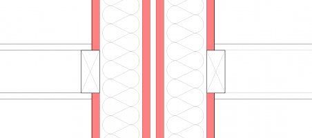

Hi all. In the intersections of the double 1-hour rated walls with the floors, even if the floor assemblies are 1 hour, the rim board feels exposed to me:
Do you think from a code perspective this is meeting the requires of R302.2.3 Continuity that the rating be continuous all the way up and down?
I would probably be ok with this, I think the rim board would take long enough to burn that it would not defeat the intent of the code to leave it exposed.
NOPE....One could argue IBC 703.2.2 though...
R302.2.1 Double Walls
Each townhouse unit shall be separated from other townhouse units by two 1-hour fire-resistance-rated wall assemblies tested in accordance with ASTM E119, UL 263 or Section 703.2.2 of the International Building Code.
