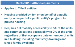

If a house or apartment it built by a Title II entity and is for rent or offered as part of a housing program by or on behalf of the Title II entry, it needs to comply with the ADAS as applicable (program accessibility). If a house or condo is built on land donated by a Title II entry is offered for sale, it needs to comply with ADAS as applicable at the time of construction. Of course, anyone can alter their own home after they buy it and it wouldn't be discrimination against yourself.
If a Title II entry does not donate land, money, etc. to the project and the home isn't used for business / public accommodation, then ADAS does not apply to the building.
Edit: I say "ADAS" and not "ADA" because they're kind of different things. Related, but different.
Here is a screenshot from a document I was sent by a CASp I worked with regarding single-family dwellings. They said that this is from our state's access compliance department, so unless our state is wrong (not unheard of), ADA can apply to single-family dwellings.
