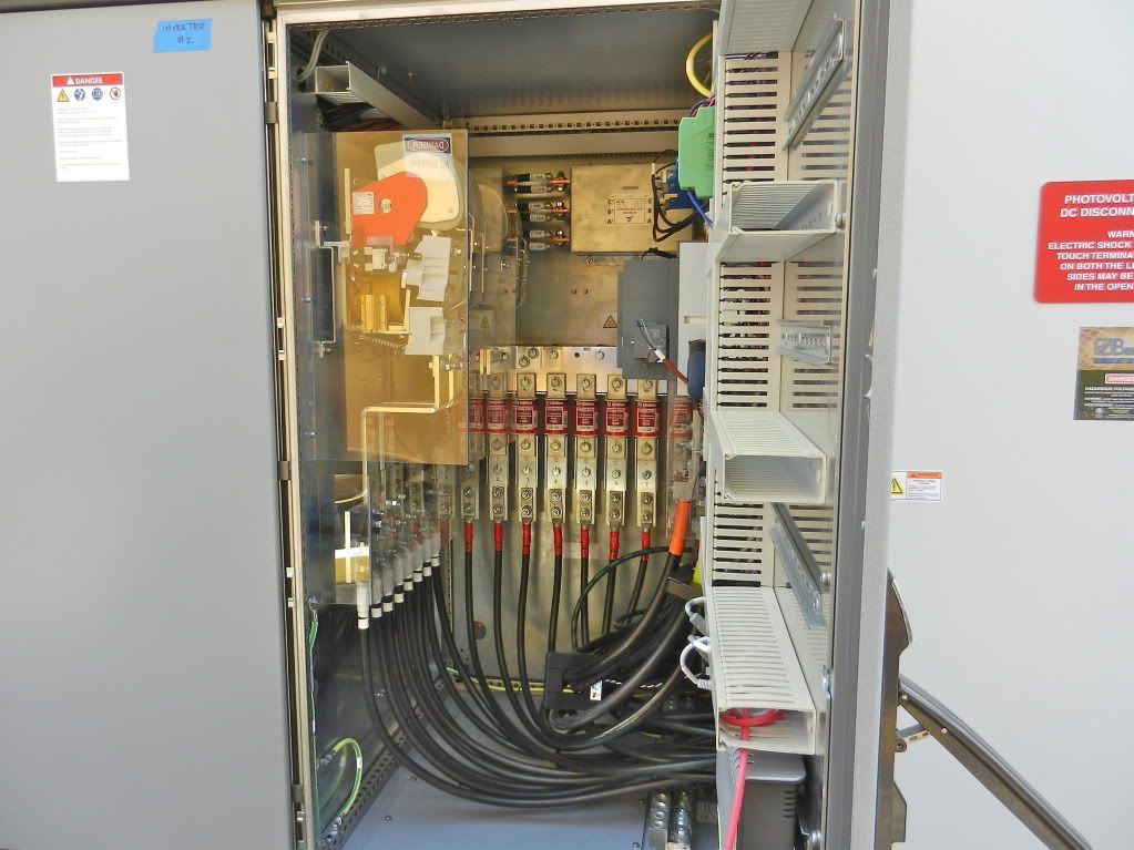

What problem are you addressing here. Wire size on the 300A fuses?
There is no working space. To even get to several of the fuses, part of the shielding must be removed. This job is located in a city near where I work and the chief el. engineer invited me along. The lack of working space was caught by him on an earlier inspection. The job is a huge solar system that I mentioned in another thread.
A while back I inspected a ****** jacuzzi tub. There was no #8 solid bonding the pump motor to the water pipe. There was no lug on the motor for the bonding jumper. The installation instructions made no mention of a bonding jumper. I called ****** and talked with their technical dept. I was assured that the model tub I was looking at is listed without a bonding jumper. They gave me the listing # and as far as they were concerned, all was good. They did not mention double insulated. I explained that the pump was not double insulated, is made from stamped steel, is the same pump I have seen many times over the years and I am not comfortable with their answer. They stood by their answer.
I brought this to the attention of the chief EE and he contacted UL. UL said that the listing is for a tub with a double insulated motor. The chief also chided me for ordering a modification of a listed piece of equipment. {I told the contractor to install a lug and bonding jumper.} I told him that the listing is void and I made the equipment as safe as I have seen them for years. He agreed and I agreed and I promised not to do it again, again. He said that UL was going to come out and look at the equipment and then deal with ******. That was months ago and I have heard nothing.

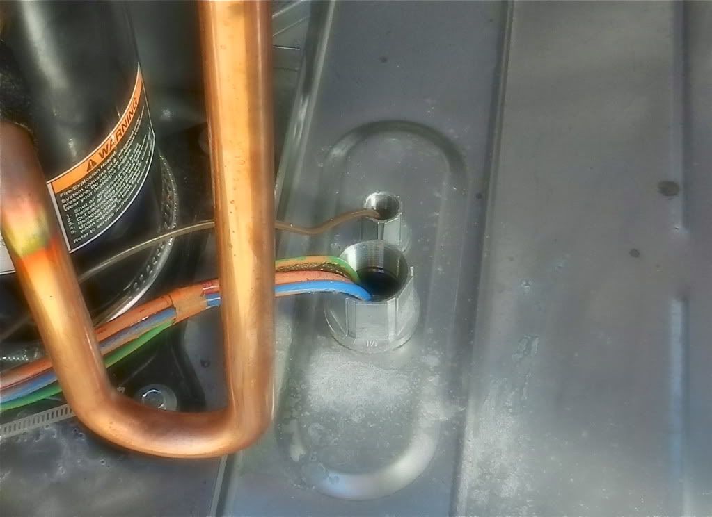

The contractor is arguing that since the equipment is UL listed with this fitting for the conductors to enter the cabinet, I can't require an insulated or smooth bushing. My feeling is that the unit will vibrate and the conductors are against the threads which could cut through the insulation.
If the code says the equipment must be listed amd it was properly listed then you do not have the authority to impose additional criteria related to vibration and possible chafing
I never understand contracts who will argue over installing something that costs a couple of bucks. Any contractor who wants to stay in business will quickly see that it is easier to spend a couple of bucks and keep the inspector happy than to **** them off.
Personally I would recommend protecting the wires if there is no code violation and note that you recommended it. Later if there is a problem because the threads ate through the wires you can easily cover yourself and prove the contractor's negligence.
Sure I do, I'm the inspector and I found a code violation. UL is not infallible and I have caused UL to revoke a listing several times.

But you do not have authority to impose criteria that is not in the regulations. Statements such as "My feeling is that the unit will vibrate and the conductors are against the threads which could cut through the insulation" give me the impression you are creating your own criteria. Where is there a requirement in the regulations or Listing criteria that requires an "insulated or smooth bushing"?
Did anyone read the units install instructions? My guess is that the manufacture intended for an installer supplied fitting to be used in those Meyers hubs. IMO the install pictured is in violation of 110.3. Also IMO Tiger has the option of 110.2 to disapprove the install.
