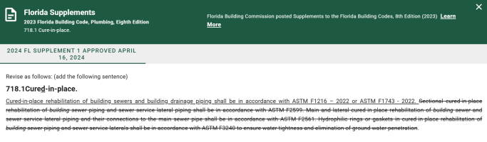

Florida Building Code and CIPP: A Focus on Regulation
Florida has been at the forefront of establishing clear regulatory requirements for CIPP installations.
DS 2015-106 (November 2015): The Florida Building Commission issued Declaratory Statement 2015-106, a pivotal decision. This statement confirmed that permits are mandatory for the installation of CIPP in residential and existing building drainage systems, as required by Section 105 of the Florida Building Code (5th Edition, 2014). It explicitly affirmed that such work falls under regulated plumbing work, subject to permitting and inspection requirements. Furthermore, it mandated that installations must comply with the manufacturer's published instructions and relevant code sections. This ruling was confirmed by the unanimous vote of the Code Administration TAC and Plumbing TAC, emphasizing that the installation must be in accordance with the manufacturer's instructions and comply with Florida Building Code, Existing Building, Section 609.1 Materials, and Florida Building Code, Plumbing, Section 303.2 Installation and Materials.
2024 Florida Building Code Supplement (April 2024): The Florida Building Code officially published language requiring CIPP rehabilitation of building sewers and drainage systems to comply with ASTM F1216 and ASTM F174315. These provisions, found in Section 718.1 of the Building Code and Section P3012.1 of the Residential Code, became effective on April 16, 2024, aiming to ensure consistent and compliant code enforcement across the state.
DS 2024-044 (February 2025): A later Declaratory Statement, DS 2024-044, further solidified the requirements. It confirmed that all CIPP rehabilitation must comply with Sections 718.1 and P3012.1 of the 8th Edition Florida Building Code (2023), which mandate adherence to ASTM F1216 and ASTM F174318. Critically, this statement evaluated non-continuous methods like "gapping," "start and stop," or "hybrid" lining. The conclusion was definitive: these segmented approaches have no applicable ASTM standards and therefore do not meet Florida Building Code requirements. Only fully conforming installations performed in accordance with approved ASTM standards are recognized as code-compliant. This decision strongly reinforces the importance of continuous, standards-based CIPP applications for structural drainage rehabilitation22. The urgency of this clarification was underscored by real-world issues, such as a Structural Integrity Reserve Study (SIRS) in May 2024 at Highland Towers, which revealed significant deficiencies related to CIPP "Gapped" material installation.
Proposed Code Modification (June 2025): Looking ahead, the Florida Building Commission is scheduled to review a proposed code modification on June 23, 2025. This modification aims to further clarify and reinforce the Florida Building Code regarding CIPP, explicitly requiring that all CIPP installations comply with ASTM F1216 or ASTM F1743. Both of these standards mandate a continuous liner installation with no gaps at branch or service connections, promoting consistent enforcement and aligning Florida's plumbing code with nationally recognized industry standards.

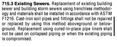

DWV is not a pressure piping system, so I would say that doesn't apply to DWV. In Chapter 7, we have 715.3:
2022 California Plumbing Code said:
715.3 Existing Sewers
Replacement of existing building sewer and building storm sewers using trenchless methodology and materials shall be installed in accordance with ASTM F1216, ASTM F2561, ASTM F2599, or ASTM F3240.
Interestingly, that only applies to sewers. So I'm unclear on whether rehabilitation of interior DWV is not allowed, or anything goes, or what. Edit: maybe not allowed, as I don't see anything applicable in Table 701.2 on "MATERIALS FOR DRAIN, WASTE, VENT PIPE AND FITTINGS".

Note that 715.3 states that CIPP shall not be used when the existing piping is compromised. That's about a mouthful hey. What does compromised include? It doesn't mean collapsed as that was mentioned separately. It is sewer pipe that has but one purpose which is to contain sewage and provide a secure delivery of the sewage to the public sanitary sewer system. If the piping is leaking sewage along the way, it is clearly compromised in the one and only function.
When there is a correction written on a trench-less sewer installation, there is usually no way to achieve compliance short of digging it up and installing a conventional sewer piping such as ABS. At the moment that a correction is written, the permit begins the journey to the expiration date.
What you're describing in LA County with CIPP really hits home with how things have evolved in Florida's code. Conducting thorough camera inspections, both before and after, including checking for water-holding spots, is non-negotiable for us to ensure compliance. Your perspective on what 'compromised' piping actually means is spot on, too.
