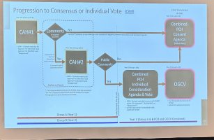

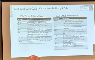

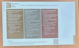

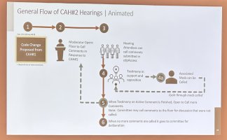

A lot of good info here but seems like you're overlooking the Group A CAHs in year one, repeat of proposals and input for Group B CAHs in year 2, and then the PCH in year 3. It's not simple and has changed a lot in past few years with pandemic and now the Group A and B business. Not easy to keep track and I feel it's de facto more restrictive and almost requires code consultants to get through it. The process with the legacy codes and early ICC was a fantastic example of democracy in action. Certainly some of the reason I got involved and participate in the committee level also.
Lots of changes and I am an I class right now on the new code adoption process. If there are any changes, I will post it here.
Are you here in Long Beach?
Pictures seem to be good summary. As noted above it's gotten very complicated. I wish there was more time for discussion. I'm preparing a comete rewrite of a section in Group B and it simply deserves more time for comittee deliberation.
No. My proposals were accepted in Orlando and no comments so on the consent agenda. I'll be in Orlando in spring, or at least plan to be.
And that is the problem with the consent agenda...If comments get missed, the change never really goes to the governmental members for proper vetting like this:

Well, if you miss submitting a comment for CAH2, can't you still submit a comment for the PCH? Maybe you need 2/3s at that point but that seems fair.
