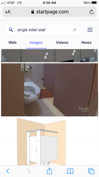

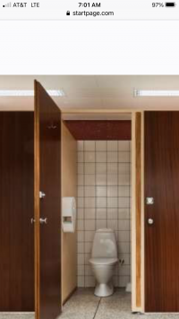

Ok getting lost
Is there a difference between a single toilet in a stall and a single toilet ,,, behind a fancy door??
