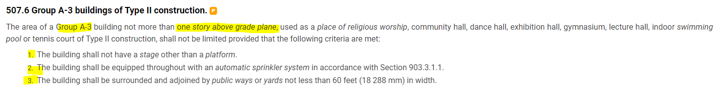

Hey all,
I am working on a 105,000 sf building of type IIB construction. The building had a change of occupancy/use about 6 years ago from Business / Storage 1 to A3 because a large gun range took over 65,000 sf. The previous architect classified it as A3 unlimited at that time. I'm looking over the code for A3 unlimited area buildings, but I don't see any mention of mixed use with A3. At the time the rest of the building remained S1/B. Is this combination of uses actually permitted in an unlimited area building? I'm working on an addition to the gun range of another 20K sf, which leaves roughly 20K sf left, which is currently vacant and I want to know if I need to alert the owner of any limits on uses for future tenants. Thanks for your input!
As long as you can meet the most restrictive of 507.4 and 507.6, I don't see why not.....All of those uses are allowed to be UL....
I do not see how Section 507.4 would work since that section is limited to Groups A-1, A-2, and A-4.
Section 507.6 could possibly be used, but a gun range is not listed as one of the permitted uses (as a matter of fact, gun ranges are not listed anywhere in the IBC), but could be argued that its use is similar to some of the uses listed (i.e., it is an indoor sport such as swimming and tennis, which have low-density occupant loads and low fire loads).
I'm surprised that a gun (shooting) range would be classified as A-3. In a shooting range, probably 75% of the space is unoccupied "downrange" space -- no-man's land. I would be inclined to classify it as Business.
That said, you can classify an A-3 building as unlimited if it meets ALL of the criteria of IBC 507.6.
For height and area, the applicable criteria for non-separated mixed uses are those that apply to the most restrictive of the mixed uses. For separated mixed uses, you have to do some math -- see IBC 508.4. Business occupancies/buildings can be unlimited if the building satisfies 507.5. Storage buildings are in 507.4. In general, it appears that the building needs to be sprinklered, and all the uses/occupancies require a 60-foot yard or open way on all sides.
You also wrote that the plan is to "add" 20,000 square feet to the gun range. Then you say that will "leave" 20,000 square feet. That sounds like you're not going to be "adding" 20,000 square feet to the range, you're going to be expanding the range into another 20,000 square feet of existing space. That's not an "addition" -- that's a change of use. If the jurisdiction where the project is located has adopted the IEBC, that puts you into a different chapter of the IEBC.

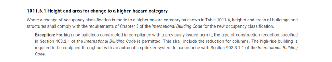

Further, if the jurisdiction has adopted the IEBC, that's where you start looking -- not in the IBC. In an existing building under the IEBC, you don't look in the IBC unless the IEBC sends you there, and then you only look at the sections to which the IEBC refers you.

507.4​
The area of a Group A-4 building not more than one story above grade plane of other than Type V construction, or the area of a Group B, F, M or S building no more than one story above grade plane of any construction type, shall not be limited........
Yes, sorry, they are expanding into 20,000 sf,. Any yes, it is a change of occupancy. I started in IEBC, it took me back to IBC.

And that's where it get's me. The code addresses mixed use unlimited area buildings for A-1, A-2, A-4, B, F, M, or S, or a combination, but not A-3.

No...it addresses all of those uses in different ways...But if you meet all of them, you are good...But I think I might agree that it is not an A3 anyway, but would need more info...

Per Section 507.4, only Groups A-4, B, F, M, or S are permitted, except that Groups A-1 and A-2 can be included with those other occupancy groups under the conditions stipulated in Section 507.4.1. There is no mention of Group A-3 anywhere in Section 507.4.
Now, a code modification could be requested to use Section 507.4 since the Group A-4 occupancy includes indoor sporting activities with spectator seating. An indoor gun range is not much unlike the indoor sporting activities listed under Group A-4, except there are no spectators. From a means of egress perspective, an indoor gun range is less of a hazard than a sporting activity with spectator seating.
