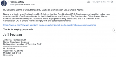

It was brought to The Vision 20/20 Project’s attention by a smoke alarm manufacturer that there were smoke and CO alarms being sold on Amazon that had not undergone third-party testing to determine if they met the requirements of UL 217 Standard for Smoke Alarms or UL 2034 Standard for Single and Multiple Station Carbon Monoxide Alarms. In response, The Vision 20/20 Project is publishing a letter asking the fire safety community to call upon Amazon and other online retailers to stop this practice. You can download the letter, along with a list of smoke and CO alarms identified by the smoke alarm manufacturer, by clicking here.https://strategicfire.org/wp-conten...0-unlisted-smoke-alarm-letter-09.24.19pdf.pdf
Sometimes the CSFM labels are fake
