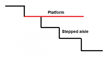

The following is from Ontario Building Code, Division B, Part 3
3.3.2.4. Aisles
(26) If a step is used at the entry to a row of seats from a stepped aisle, an unobstructed platform not less than 800 mm
square shall be provided adjacent to the aisle.
I can't imagine how the platform would look like in real situations where there is a stepped aisle. When there is a stepped aisle, the rows of seats would be on successive tiers, how would this situation accommodate a flat platform? (the 800mm platform would extend two to three treads of the stepped aisle, so the interface between the platform and aisle would look like this (cut a section along the stepped aisle), am I correct?
I think the condition is rare, and most often is a step down into a row of seats from an aisle tread. The 800 mm square could be the space in a row in front of seats.
The only time I've done this is where a landing is required in a stepped aisle to change direction. Enter a balcony from side and landing for a 90 degree turn is in line with first row, but needs to be 1 step to second row, first row is a step or 2 down. (A better design is to let the landing project forward of the first row, which is not hard in a site built theatre, but you get into problems with factory grandstand and bleacher systems where "irregularities" are expensive.)
You're thinking of a standard step = think of an arena or theatre where the steps are, like, 90 cm apart.
