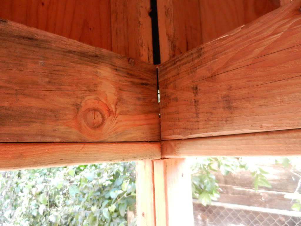

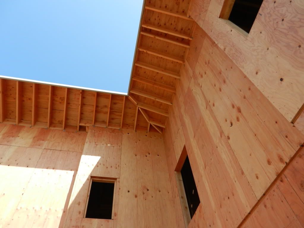

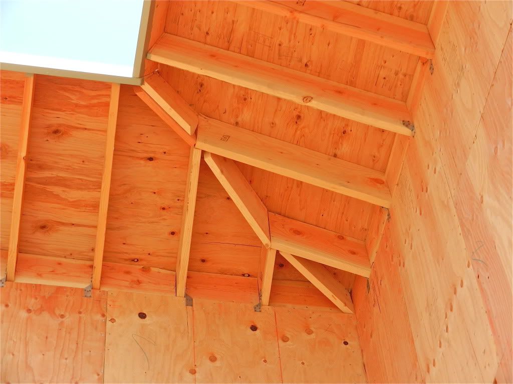

I was inspecting under slab plumbing on the next building when I spotted this.
Shirley, they will ask: "Well what do you want us to do." My answer will be: "Something other than this."
wow, thats about all you can say, besides what were you thinking? I need to come to your area, you make all my builders look like they are the best in the world.
MtnArch said:
Gotta ask ... just what did the plans (or truss drawings?) show?
I was just snooping around and haven't looked at the roof plans. When I can get away with it, I like to look a building over, alone, with no distractions.

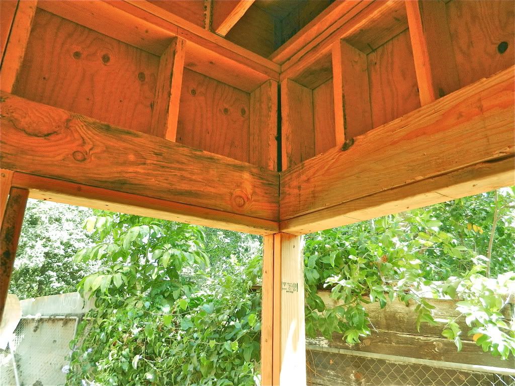

I also spotted this. I'm not saying it's absolutely wrong yet only because I haven't seen the framing plans. Both headers stop short at the corner. There appears to be nothing in the corner which is supporting a floor and roof.
