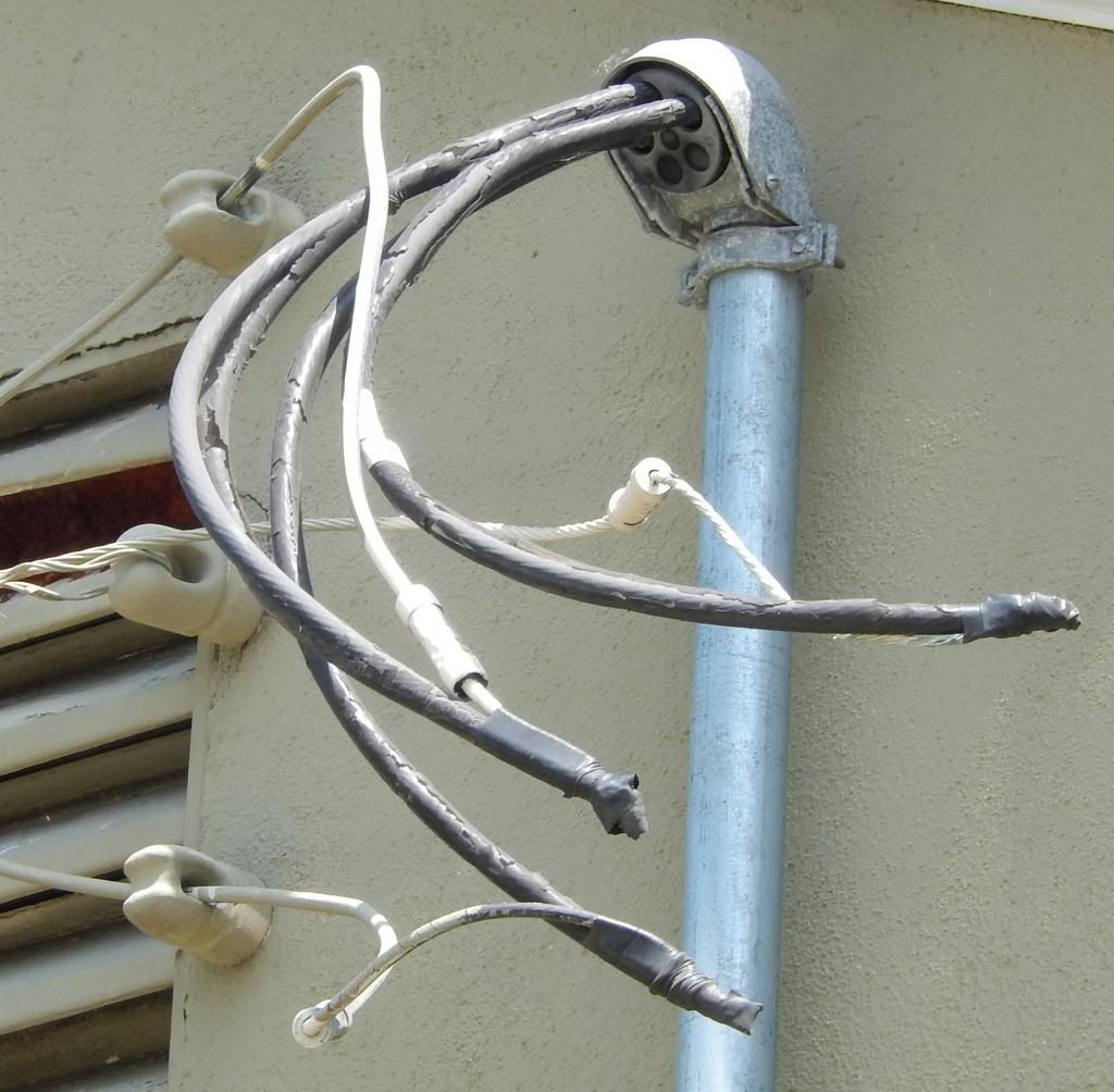

Can anyone suggest what type of wire this is. It is part of a bootlegged 100 amp residential service of undetermined age. The outer sheath has not stood up to the environment. What I need to decide is whether to ask that the wire be replaced. What purpose does the outer plastic sheath serve?
Yes, it appears to be THHN/THWN which is not UV rated and this is the result. We do not allow exposed THHN/THWN for installations like this where they are exposed.
I believe there is some THHn/THWN such as Thwn-2 that is sunlight resistant. The sunlight resistant conductors are black in color thus red, blue, etc are not sunlight resistant
• mTW or Thhn or ThWn-2Conductors shall be UL-listed Type MTW or THHN or THWN-2* gasoline and oil resistant II, suitable for operations at 600 volts as specified in the National Electrical Code. Sizes 14
through 1 AWG shall be rated VW-1, larger sizes shall be listed for CT use. Sizes 2 AWG and larger listed and marked sunlight-resistant in black only. Conductors shall be annealed
copper, insulated with high-heat and moisture resistant PVC, jacketed with abrasion, moisture, gasoline, and oil resistant nylon or listed equivalent, as manufactured by Southwire Company or approved equal.
My understanding is that the nylon jacket is just a protective covering and not an important part of the conductor.

Thanks Dennis,
Would you happen to know when THWN-2 became available?

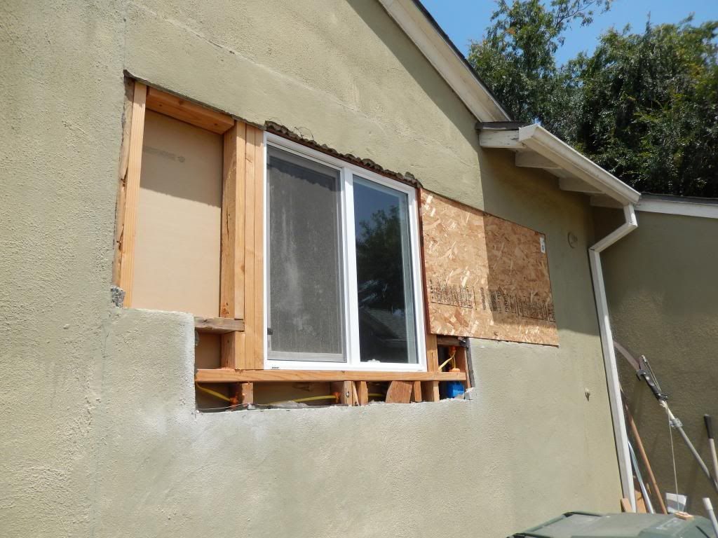

This is over the kitchen sink. This one mistake has generated ten minutes of loud complaining. Every mistake that's made becomes my mistake because I didn't tell them about the mistake before the mistake was made. If it were up to them, I would have been in the room when the project idea was first conceived. I hope everybody is pleased with the paint colors because, if not, it will somehow be my fault.
They make a point of telling me what every mistake costs. They asked "What should I do with this window"? And added "Home Depot isn't going to take it back. Do you want the window? Should I donate it? There's no way to make this work? Why aren't you helping us? What else aren't you telling us until it's too late? Are you going to bail us out when we run out of money? What happened to serving the public? You do work for us you know."

Can't help with that but I would guess somewhere between 2002-2008. That wire may very well be thhn and not thwn
I'm leaning towards voiding the permit and requiring a licensed electrical contractor for a new permit.
