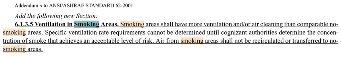

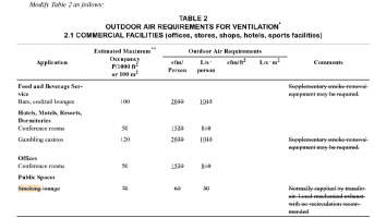

    I'd take a look at IMC Section 403.3.1.1 and the associated Table.
    For retail stores, sales floors and showroom floors, particularly smoking lounges, the minimum ventilation rates are 70 and 60 for OCCUPANT DENSITY#/1000 FT^2a and PEOPLE OUTDOOR AIRFLOW RATE IN BREATHING ZONE, Rp CFM/PERSON.
    Note that footnote b specifies that "Mechanical exhaust required and the recirculation of air from such spaces is prohibited. Recirculation of air that is contained completely within such spaces shall not be prohibited (see Section 403.2.1, Item 3)."
