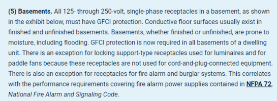

Lets go at it from another direction....If the NEC is considering any basement damp, I am considering every slab as such...And I would likely argue that in the slab is embedded and/or similar to the "shallow chase" provision
Location, Damp.
Locations protected from weather and not subject to saturation with water or other liquids but subject to moderate degrees of moisture. (CMP-1)
Informational Note:
Examples of such locations include partially protected locations under canopies, marquees, roofed open porches, and like locations, and interior locations subject to moderate degrees of moisture, such as some basements, some barns, and some cold-storage warehouses.
But it doesn't consider any basement damp. It considers "some" basements damp. Any new building with a damp basement has a serious design problem, but there certainly are plenty of such buildings in the existing stock.
No, not every slab is damp. Concrete doesn't generate moisture. If a piece of wood in the same location wouldn't be subject to "moderate degrees of moisture", then concrete in that location won't be damp.

We will agree to disagree.....
If it is conductive and wet enough (with a vapor barrier) to require GFCI, that is all I need....
