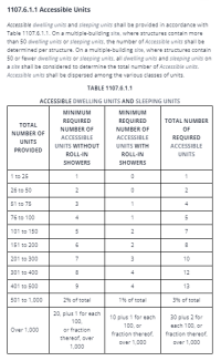

Here is PA's scoping requirements for accessible units:
https://up.codes/viewer/pennsylvania/ibc-2018/chapter/11/accessibility#1107.6.1.1

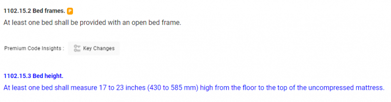

Here's an example from Colorado, where they adopted the 2018 IBC which in turn references 2017 ANSI 117.1 for technical provisions.
Here's where 117.1-1102.15 adds a bunch of requirements for freestanding furnishings (bed frame and mattress!) into the building code for accessible dwelling units.
It must get interesting to require furnishing to complete a final building code inspection, when most departments won't allow furniture move-in until after C of O.
1102.15 Beds
In at least one sleeping area, a minimum of five percent, but not less than one bed shall comply with Section 1102.15.
1102.15.1 Clear Floor Space
A clear floor space shall be provided on both sides of the bed. The clear floor space shall be positioned for parallel approach to the side of the bed.
Exception: Where a single clear floor space positioned for parallel approach is provided between two beds, a clear floor space shall not be required on both sides of the bed.
1102.15.2 Bed Frames
At least one bed shall be provided with an open bed frame.
1102.15.3 Bed Height
At least one bed shall measure 17 to 23 inches (430 to 585 mm) high from the floor to the top of the uncompressed mattress.
1102.15.4 Wheelchair Charging Area
The clear floor space required by Section 1102.15.1 shall also serve as a wheelchair charging area complying with Section 906.
