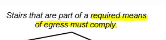

What Stairs Require ADA Compliance?
12,952
Interior and exterior stairs that are part of a required means of egress must meet the Standards. Compliance is required for all stairs on required egress routes, including those comprised of a single riser. The Standards do not apply to stairways that are not part of a required means of egress nor to alternating tread devices and “ship’s ladders.” The Standards exempt aisle stairs in assembly areas, stairs in non-public areas of detention and correctional facilities, and stairs of play components.
Agree... but I'd make note of the exceptions provided in 1009.1. For some reason, I have seen that these can be overlooked.
Also, really appreciate the topic. One aspect that I have seen as a point of confusion frequently is the difference between an accessible means of egress (Sec. 1009) and an accessible route (Sec. 1104). Stairs are a viable component of an accessible means of egress, but obviously are not a component of an accessible route. I see a lot of confusion regarding the two topics. Interested to see if a discussion follows regarding accessible MoE vs. accessible routes.
Accessible routes are governed by ADA and IBC Ch. 11, and relate to normal operations of a building, in particular, as it relates to those with limited mobility or a disability.
Accessible means of egress, a function of IBC Ch. 10 (see 1009), is concerned with those non-typical operating conditions such as a fire or other emergency. In the case of these non-typical operating conditions, the accessible means of egress is not necessarily the same as the accessible route (per ADA/CH. 11).
You must separate in you review accessible MoE and accessible route. The requirements are not the same nor interchangeable.
