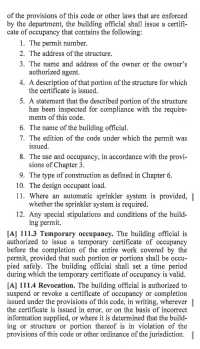

Other than the area approved by planning, the code seems to require all that, and more:
Getting building departments to do that, though, ain't easy. In my architect days, I went out to look at a factory that wanted to double the factory with an addition off the back. It was a pre-engineered metal building, about 35,000 sf of industrial space with a 10,000 to 15,000 foot office and showroom wing on the front.
The certificate of occupancy just said "Factory." No construction type. No mixed occupancy. No building area. Nothing about sprinklers. Just "Factory."

I answered based on what I believe the code requires, not on what I see daily. In my experience each AHJ is wildly different, with most having little understanding of the importance of a C of O. Most seem to have no idea how the C of O works for the future, and absolutely no adherence to the items the code requires to be on a C of O.
IMO a C of O, with all the required information is the backstop for future renovations, and a baseline for the continued legal operation. If the C of O's were properly issued and properly revised, and properly displayed it would bring clarity to owners and building officials. One of the biggest problems I see and deal with are missing design occupant load, and missing construction type, which are the areas I believe are critical when alterations are made (assuming a C of O can even be found). The code under which the C of O was issued would also be very helpful, instead everyone appears to guess, which is vital when applying the IEBC, and trying to figure out if they met the code under which the project was originally permitted. VERY seldom do I see this presented by a DP, and when I do see it, it is often wrong....likely just a guess because they also couldn't find the information.
So often plans are approved with special conditions, but no documentation is ever required or provided. For example, if some sort of allowance is made to artificially reduce occupant load that needs to be documented, among other places, on the C of O. I also see a lot of confusion about construction type. So often I see an architect submit for plans on an existing building with a "proposed" construction type, often using the word "assumed" construction type. How can we proceed on an assumption? It should be easy, a C of O should be produced that tells us. I have researched many projects and found multiple C of O's over the life of a building with multiple different construction types. DP's and BO's aren't doing there jobs in this regard.
I require a code analysis for everything, partly because I suspect the C of O will either not be issued or will be issued with missing or incorrect information. I do this so everyone knows what I used to review the project. If there are special conditions, I prominently place those conditions on the plans, again, so the next people using those plans to know why something was either approved or not approved. All that SHOULD be on a C of O, but I can;t recall ever finding one with all the correct information.
Lastly, I think the C of O should be required to be displayed and produced by applicants for permitting. I often see the "first dollar" displayed in a business, but not a C of O. I thought that was a requirement at some point, but not sure it is still in the code.
The code gives us a not vague list, tells us what SHALL be on it, and when it SHALL be completed. Minor rant, but one that plagues my reviews on existing buildings. Seems so simple.

Having encountered certificates of occupancy with zero useful information on more than one occasion when wearing my architect hat, I agree completely. The code tells us that we "shall" issue certificates of occupancy, and the code tells us what information has to be on it -- as a minimum. This has been in the codes for a very, very long time. It's difficult to understand how or why many building departments still don't do the minimum that's required. The CofO is -- along with the actual plans -- arguably THE most important document in the entire file record for a building.
