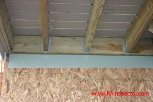

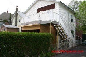

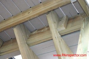

Here is a very good example of why we hear excuses from contractors. In this case another municipality issued a permit, inspected and signed off on this installation. What issues do you see here that they missed?

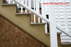

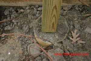

Ledger attachment and flashing, openings at stairs/ guards, overspanned decking likely at stairs, stringer support (although there is not a good code section for that, not sure how the posts are attached at the bottom, looks like they have a double rim and single-ply beam?
I can not be responsible for the actions or lack of action of the neighboring jurisdictions inspector. I am responsible to enforce the code as written and I will even try to explain it to you if you will listen, not argue. It is my signature on the occupancy or completion certificate not the neighbors, architect, engineers or your friend who told you it was ok.

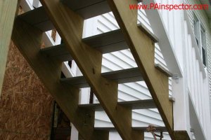

Top of stair stringers attached with anti-gravity paint. In picture 2, looks like the double rim board-joist on the left is not properly attached to the ledger. Ledger is attached to the house with the same anti-gravity paint ... don’t see a post at the house so its not self-supporting.

AC hanging by a rope from the stairway. It least it's over 6" from the ground.
What's with the area where there is no siding where you can see brick above the deck? Might cause water to get behind window flashing.
Would like to see the header for the garage door opening.

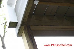

looks like 4x4's posts for top stairway landing, need 6x6 if over 8' high.
last deck joist has no joist bracket.
Looks like might be just 2x4 joists for the garage roof. No tables for a roof with a slope less than 3/12. Here in the north it would need to be engineered. But how do you handle it where there is no snow?

Those stairs looked exactly the same for the next 3 years that I lived next to that house with the only change being vinyl siding. Thank you BIU for setting the example.
yeah, those stringers are an accident waiting to happen
