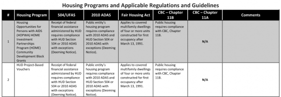

A private developer builds 200 unit housing project.
100 units designated lower-income and are provided with project-based rental vouchers from a local Housing Authority and are considered "public housing".​
The other 100 units are market-rate and are privately funded.​
CBC 11B / ADAS 233.3.1 requires a minimum of 5% of the units to be mobility accessible.
  • How many units need to be 11B/ ADA mobility accessible: 5 units, or 10?
  • Or to put it another way, on a mixed public+private development, does the 5% rule apply only to the # of units with project-based vouchers, or does it apply to all the units on the site?
(This question is not about 11A or FHA, which is a separate subject - -it's purely about ADA.)
  • None of the 200 privately funded single family free standing dwelling units are encumbered by the ADA.
  • HUD said project-based vouchers (assuming this is what you mean) are the way the tenant pays for the rent. Paying the rent with vouchers does not turn the project into a government funded project.
Jean, the California State Architect has determined that Project-based (not tenant based) Vouchers constitute a government funded benefit to the project, not just to the tenant. See:
Here's an excerpt - - see item #2:
