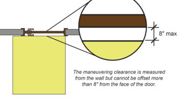

See my markup below of ADA / CBC 11B 404.2.4.3 regarding obstructions (such as extra wall thickness) that create a recess at accessible doorways.
We know that when X>8" the full 18" maneuvering space must be provided.
The question is, when X<8", and the recess is allowed:
  • Do you measure the perpendicular 60" clearance from the face of the door, as in figure #1 below?
-OR-
  • Do you measure the 60" from the face of the obstruction that creates the recess, as noted in blue in figure #2 below?

The Federal Access Board, includes the recess in the clearances.
measured at/from the door
I had the same image in mind when I read the original post. Here’s a link to the U.S. Access Board page with this graphic, you can download a PDF using the blue “PDF” button at the top-right.

My understanding is that the 60” measurement would be taken from the wall (D) as long as nothing else (door casing B and baseboard C) pushes the door maneuvering clearance more than 8” away from the door, this is per the U.S. Access Board Technical Guide “Recessed Doors and Gates section:
The plan view illustrations I have seen show the wall with a finish material on it then casing extending beyond that into the door maneuvering clearance. But they never show the top edge of the baseboard below, so I can only assume they are measuring to the wall proper (say at 34” above the floor.) But maybe the intent is that baseboard is included in the term “casework.”

U.S. Access Board Technical Guide Chapter 4 says the maneuvering clearance is measured from the wall. If you were to measure from the face of the casing you know you’d be covered, but I get the impression you’re fighting for every inch you can get.
Yeah, my problem is that they never provide a helpful illustration that shows clearances when recess X is more than 0" but less than 8", as I attempted to do with figure #1 in my original post.
This is part of the problem, the drawings in the ADA are weak and the text doesn’t state from where the door maneuvering clearance is measured. The U.S. Access Board Technical Guide shows the measurement to the wall (which matches the text in that guide) but neither the ADA nor A117.1 specify to where the dimension should be taken.
