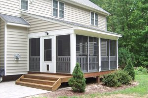

Well, now you have. How do you ventilate this porch roof? It is screened in and not in the thermal envelope. Other than a vented soffit, which by itself is useless, how do you ventilate it?
Not that I think you should if porch is open, there are ridge vent products that can be used at the wall flashing line, plus those hideous boxes and gable end vents. If this were enclosed and conditioned, you'd be required to do that. But YC and I are trying to understand how an attic above a house isn't outside the thermal envelope.
There are products that go at the top of a shed roof like that, where it abuts the vertical wall, that function like a ridge vent. Or put gable vents at each end.
Or a double roof:
But how to ventilate it begs the question of whether or not ventilation is required. I simply pointed out the flaw in your rationale for saying that attics outside of the thermal envelope don't require ventilation. You may (or may not) be correct about the ceiling cavities above porches but, if you are correct, it's not because they are outside of the thermal envelope.
