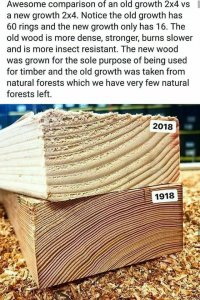

Our San Diego home is framed with old growth redwood. Built in 1911. It is unlike any other wood available today. Floated the logs in rafts down from the pacific northwest.
The fact that replanted, managed forests produce trees with wider (less dense) growth rings has been acknowledged for decades. When I first started "practicing" architecture in the early 1970s (because we never seem to quite get it right), it was accepted lore that Douglas Fir was the best, strongest dimension lumber available. And then, somewhere around 1980, the lumber industry came out with new grading rules and new span tables, and by some miracle hem-fir had magically become "better" than Douglas Fir (longer allowable spans, grade-for-grade) for the same loads. This has since pretty much gone back to closer to where it was, but for a while there it was difficult for anyone to understand how Douglas Fir had suddenly been displaced as the strongest framing lumber species.
At the time this happened, one of the structural engineers the firm I worked in used was also a professor of engineering at a local university. I discussed tis with him at the time, and his explanation was all about the difference between old-growth vs fast-growth timber.

Allowable stresses in Southern Pine keep decreasing because the newer fast-growing wood has more defects and a greater variation in strength for the same visual grade.
I saw an article which said (if I remember right) that the design stress is what 85% of the wood has to exceed, and that even though the mean strength is the same there is more weaker wood so the allowable stress was decreased.

I was wrong about 85%, it's actually 95% has to exceed the design value according to an article "Effect of Variability on Lumber Design Values" by Don Bender & Frank Woeste that I downloaded from https://framebuildingnews.com shortly after the latest Southern Pine values were established.

The article wasn't trying to establish a regulation. It was just trying to explain why the SPIB adopted a new set of design values (which were generally lower than the previous ones) because newer visually graded lumber had greater variation in strength than older lumber.
