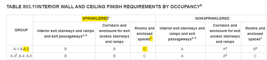

Am I correct interpreting table 803.11 to mean that I can have as much wood paneling as I want in A2 assembly 'Rooms and enclosed spaces' as long as it is Class C, and that the 1,000 sf limit applies only to Lobbies?

If the building is sprinklered. If not, see footnote 'e.'
If unsprinklered, also see footnote 'd.'
Does keynote 'd' apply if it not shown as a superscript in the header or categories? It appears in the Non-sprinklered categories but not in Sprinklered.
No, Footnote d does not apply if you have a sprinklered A-2 building. Footnote l (on the “Sprinklered” main column heading) applies to your project, that only specifies which kind of sprinkler system you have. Footnote c (on sub-column “Rooms and Enclosed Spaces”) applies, when the footnote is on the column heading it applies to all groups in the table.
Footnote 'd' applies where it appears in the table: it applies to non-sprinklered corridors and enclosures for exit access stairways and ramps inall A occupancies (the 6th column in the table).
