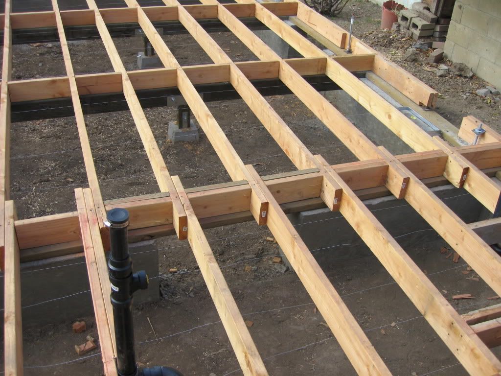

The workmanship was good and I could tell that they cared. So whats wrong?
you mean double the blocking infill does not serve as a header? (center)
anchor bolt washer might be a tad offset from the sill plate? (center right)
and moisture barrier may be difficult to install depending on worker girth
or rodent control provisions and not sure of reason for missing band joist segment
anchors at left, / right of open footing segment?
end bearing / cant see if its there /on space blocking (lower right)
joist spacing change for a reason on left bay (center to top)

what code section for pressure blocking?
It somewhere between "you know, that section" and "the other section"
