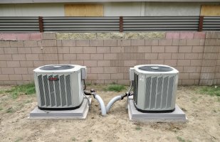

I am now going to show you two examples of an average day. Both are related to working space about electrical equipment.
This is a picture of a patio cover and the inspection was for lath. I was filling in for an inspector and had not been there before. Framing, rough electrical and rough plumbing had been signed off.

That is not an unusual day. So you would birth a cow over a condenser disconnect that's off by four inches? I suppose you would drop a herd over these.
I was a contracted inspector after I retired from LA County. In those examples, and many more, I simply refused to proceed. ..... too many .... the work dried up.

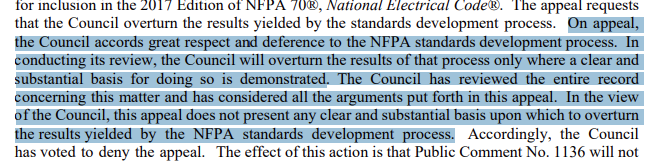

How about some specific examples of how private industry gets its way with code changes? Glad you asked.
Tesla asked to have the ampacity tables changed to accommodate car charging cables. This was rejected by CMP-12. Tesla then filed an appeal with the motions committee to have the decision by CMP-12 overturned. The required 2/3 majority Tesla needed was not achieved so the tables stand.
My point with this story is that there is a system in place and industry does not always get its way in contrast to popular belief. There is a large cross-section of industry professionals that sit on the NFPA 70 code panels and all changes are taken seriously, and a solid case must be made for the change. In the case I presented to you in the beginning of this reply, private industry lost out.
Again, it is always easy to say things are corrupt, but much harder to try to fix what you believe is corrupt. There are a lot of code panels to join if you want to make a difference.
General Cable wanted a change that was denied and like Tesla, General Cable filed an appeal with the Motions Committee to overturn the code panel. Again, private industry did not get their way. You see, there is a process and procedure and it may not be as skewed as one thinks.
