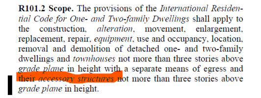

I'm just not finding much, if any, specific information about unheated, non-electrified, unplumbed, windowless storage sheds.
I did find this:
R105.2 Work exempt from permit.
Building
1. One story accessory structures, provided that the floor area does not exceed 200 square feet. (18.52 m2)
Considering that I am at 192 square feet, I would think I could show them this, and get them to agree, since they say I have to follow the codes. But their published rules say anything larger than 120 square feet, so I'm not going to be allowed to do this. Confusing...
This is the exact kit I was given: https://www.shedsforlessdirect.com/manuals/Sierra-Shed
This is the permitting information the company that makes them gives: http://www.barnkits.com/docs/PermitSet.pdf (note, this pdf is fairly generic, and is actually for another model of the exact same size)
And this is why I don't understand the codes. There is absolutely nothing in them that covers anything like this. I did see one part that listed "sheds" as Group U (Utility) without giving another word of information. That was 312.1 = They shall be built in accordance with these codes... Someone will have to be able to give me a really good explanation why 6 more feet in one direction, and 2 more feet in another direction relieves anyone of the responsibility of permitting. Especially when the codes say permits shall not be required for structures of less than 200 sq. ft. And it's being built from a pre-cut, pre-engineered kit. Do they have different codes in different states?

So you need to see what is adopted / wording by the local city for
R105.2 - Work Exempt From Permit.
EvilT-
I think you have few options you'll like. I see the kit has an optional framed floor which I'm guessing you don't have, but as I suggested you could build and probably support with some small concrete piers. You could even use wood piers if it met the correct treatment for foundation.
The thickened edge monolithic slab discussed previously.
A short stem wall on a footer. Could be pretty simple. Then a 3 1/2" slab on grade inside that.
Or find an engineer to design an even simpler foundation and stamp the design.
Those should all be accepted. But try sketching something yourself that seems reasonable and submit with the manual for permit. No promises. Remove top soil and organic matter, 4" of crushed stone, and 4" of concrete, thickening to 6-8 inches wide at edge maybe to 6 - 8 inches thick.
You are correct that the IRC is not very lenient for very small (compared to a house) buildings. There just isn't a constituency for that kind of building to develop and shepherd code change proposals through the system. Home building is big business. Shed building not so much.

Even more frustrating, because there is no place to go "see what is adopted... by the local city". They just give a link to the IBC and IRC 2020 Amendments on the State Department of Community Affairs website.
Here's the thing that keeps bothering me. All these codes talk about are dwellings. A storage shed is not a dwelling. So, how can these codes even apply? I'm not constructing a dwelling! I'm putting together a shed...

No no no
Every city I have worked for was required to have a code book for the general public to see,,, plus access to local amendments..
Go to the city and ask
Or another way is do open records request for that code section
If they have adopted the IRC, and you can see the local amendments, the unamended code is available at ICCSAFE.ORG, here is the IRC.
All the codes;
We used to keep copies on hand at the clerks office, but when ICC made the electronic versions viewable, the Clerk said that was sufficiaent, as long as we posted the links.
Take your booklet in, ask to talk to most senior person available, tell them what you would like to do for a slab foundation, and then you'll know. The article linked provided a very simple description of a minimal slab foundation.

I thought the 110 sq ft only exempted him from permit, but still has to meet code, which for a building requires a foundation and footer.
"R105.2Work exempt from permit.
Exemption from permit requirements of this code shall not be deemed to grant authorization for any work to be done in any manner in violation of the provisions of this code or any other laws or ordinances of this jurisdiction."
They still need to be anchored down
