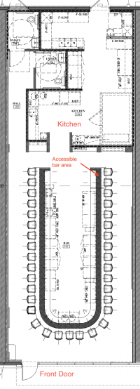

I'm a small restaurant owner in Texas (Tabu Shabu) and we are battling with our landlord to get through our final TAS (Texas Accessibility Standards) inspection and violations. I have a number of items I would like to get some opinions on, including this one. I have a separate post for a different question. For reference, this was a brand new shell space and we opened for business in September 2022. We are a Japanese hot pot restaurant and the entire dining area is a U shaped bar (picture below).
The inspector has called out our ADA accessible bar section as not having enough clear floor space. (902.1 General)
Compliant clear floor space at “accessible” bar counter not provided. 45.5” is provided. 60” minimum clear width for 2 accessible spaces.
They did not call out the width of the actual surface, but the area underneath. We have a section at one end that was designed to be accessible with the correct amount of knee and toe clearance.
Question: Under the accessible section, one side is a wall as part of the overall bar structure, but the other side is open. Could the open side be considered for clear floor space to meet the 60" requirement?
Thank you!
If I understand it, you have 45.5" linear of counter for those two spaces? So one person gets 30 and the other 15.5"? Is there another 36" beyond that because the clear area for a wheelchair space can't overlap the aisle. I'm guessing there is barely 36" from end of bar to wall.
I also would wonder if when a wheel chair is in it's 30x48" space, if there is 36" clear behind, which is required.

You need to have (2) accessible dining spaces as required by TAS 226. 5% of 35 = 2 seats. Each seat needs to be 30" wide. Both seats need to be roll-under (knee and toe clearance). No, you cannot seat another accessible use patron at the end of the bar as it lacks roll-under.

You've got a mess. I'm sorry. Whomever designed this erred and I don't see an easy modification to meet the intent of the law.
The building official in me, the architect in me, and the accessibility consultant in me for once all agree: No.
It should be obvious that the intent for the clear floor space being 30" wide is to accommodate a wheelchair -- which is approximately 30 inches wide. If the Texas accessibility standards allow you to cluster your two wheelchair seats together like that, then you have to assume that at some time there might be two patrons in wheelchairs dining together. If your counter space is only 45-1/2" wide and the under-counter space to the left is constrained by a vertical barrier surface, what do you have left? The left-hand patron, even with his/her wheelchair as far to the left as possible, takes up 30 inches. If the other wheelchair patron manages to position his/her wheelchair as close as possible to the first one, that second patron is now sitting in front of 15-1/2 inches of dining surface. In other words, he/she is effectively center right on the edge of the table/counter.
As a designer and as an accessibility advocate, my unsolicited opinion is that cramming the two required wheelchair seats together at the end of the counter (at the "back of the bus," so to speak) is poor design anyway. In theaters, each wheelchair seating location is required to have an abutting companion seat. Apparently the Texas standards haven't extended that concept to restaurant seating, but IMHO common sense should do so.

I suppose one fix would be to extend the counter and remove the isle. There is already an opening on one side of the bar that would allow staff to move between inside the U and outside. There is one other Tabu Shabu location set up the same way with only 1 opening, and it just creates some additional time to get to the outside of the bar where there isn't an isle.
I'm just a little confused that the initial plan review or final inspection didn't actual call out the surface space not being 30 inches - only the clear floor space. Even the code itself mentions floor or ground space, not surface area.
You might get away with extending counter but putting the wheelchair spaces furthest from the entrance and now furthest from the restrooms, also furthest from staff assistance, it feels discriminatory.
I agree with you. In retrospect, we should have had the ADA on the end of U closest to the bathroom hallway. To completely retrofit the bar is not something we easily do as there is a dump sink and related plumbing at that end. If open additional locations, I will make sure the accessible seating area is in a better location.

The bathrooms are compliant for both the toilet and lavatory area, including 60" of clearance and differ from the plans slightly. We did receive a violation that the mens bathroom (the one directly at the end of the hallway) has 17" (instead of 18") of maneuvering clearance on the pull side of the door. Our contractor installed a swing in door versus swing out as per plan. We are trying to get them to fix that by reinstalling the door.
As for the issue with the ADA seating at the far end of the bar, our intent was never discriminate against a disabled person. The other restaurants with similar configurations all have accessible seating at the end and we followed that. If we were to place 2 accessible seats in the middle of the bar area, would create issues for contiguous seating for larger parties. In the year and half we have been open, we have only had a single wheelchair bound person dine with us and they were fine with the accommodations. We have a total of 35 spots at our bar (including the 2 ADA). If we were to have more than 2 require the accessible seating, they would have to wait for that area to open up.
I would absolutely reconfigure the ADA to be on the end closest to the restrooms if we had to do it again. Not only is that a straight shot from the entrance, but would be closer to the restroom as you indicated. I believe our path forward to achieve compliance will be to extend the ADA section by 11.5 inches.
