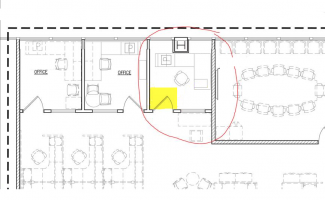

I am working on a tenant fitout and there is an existing office that does not have the door clearances within the office. Below is a screen shot of the office in question. I remember but can not find that individual offices are not required to be ada compliant. I looked all throughout section 11 of the IBC for an exception (includeing specifically 11.03.2.2) regarding work areas, but it says:
1103.2.2 Employee Work Areas
Spaces and elements within employee work areas shall only be required to comply with Sections 907.5.2.3.1, 1009 and 1104.3.1 and shall be designed and constructed so that individuals with disabilities can approach, enter and exit the work area. Work areas, or portions of work areas, other than raised courtroom stations in accordance with Section 1109.4.1.4, that are less than 300 square feet (30 m2) in area AND located 7 inches (178 mm) or more above or below the ground or finished floor where the change in elevation is essential to the function of the space shall be exempt from all requirements.
Take special note of the AND part which is why I don't think this section allows for my excemptions.
Does anyone in the collective hive know if the individual offices in a business use group can be exempt from ADA/accessibility requirements and if so, can you point me to that section?
Thank you in advance

You say the office itself is existing. Is everything existing / no change that is highlighted in yellow in the image below? Such that the only new stuff may be the furniture and office equipment?
Thank you for the welcome. I stumbled across this website when I was trying to find my answer, sometimes the algorithm gets me more than just synchronized canooing videos! :) I hope I can contribute in some small way.

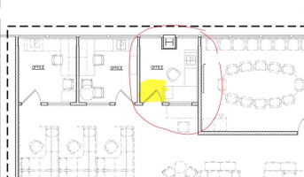

To answer your question. The office itself (partitions and exterior wall) shown are existing to remain. The furniture itself is existing but a comment came up from a reviewer that the existing does not meet accessibility standards for pull side of the door. Regardless if the existing furniture is there, or we were putting in new furniture, I originally thought there was some exception in the code that allowed single offices such as this to be non-compliant. But my "thought" has to be backed up by some actually/referenceable code (plus for my education as well.) I know I could spin or adjust the furniture to make it accessibly compliant but some office users are very particular how they want their desk (I guess in this case, the person doesn't want their back toward the door).
The furniture can be moved or changed if the employee becomes disabled, or the employee can be given a different office.

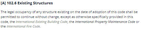

1101.1 says that IBC chapter 11 covers design and construction of facilities. You are neither designing nor constructing this existing office. It's already there, and you aren't changing it.
From IBC 202 definitions:
Note that the definition of "Facility" does not appear to include non-fixed furnishings.
Now look at the overall scoping of 2021 IBC as it relates to existing structures that aren't changing.
What I'm saying is, your plan already complies with 2021 IBC as that code applies to existing spaces that were previously legally permitted and are not being changed. There should be no accessibility corrections from your plan checker regarding the pull side clearance of that particular door, especially if you mark it "existing - no change".

Why is the furniture on the plans?
I asked myself the same question. Maybe to show compliance for requirements for aisles per 1018.1, “Aisles or aisle accessways shall be provided from all occupied portions of the exit access that contain seats, tables, furnishings, displays and similar fixtures or equipment.”? But if that was the case then there’d be a few dimensions showing how much space is available around the furniture.
My guess is that the plan with the furniture was intended to be the “pretty picture” to get owner approval and they left the furniture on for the permit drawings without thinking about it. I’ve seen a few sets of drawings with building sections showing scale figures and cars and trees in the background - none of which were needed for drawings for permitting and construction.
When I am the design professional of record and it is not in my contract to provide furniture design, best practice is to show dotted lines at the doors that indicate the minimum required clearances per ADA and/or the applicable local code (whichever is more restrictive). See example of the blue lines at the door for the I.T. staff office below:
That way if someone in the future places furniture in a manner that violates those regulations, you are already on record as having provided a code-compliant solution.

I do provide a hallway dimension elsewhere on that plan. I'm just showing small excerpt of the drawing.
We actually have the clearances baked into the Revit family for doors.

In general, looking through both the Prescriptive Method and the Work Area Method for Level 2 I don't see anything that addresses the placement of FF&E in an existing single-occupant office. IMHO, this would be left to the ADA under the indivudual worker accommodation provisions rather than be under the purview of the building code.
I'm sure the goal here is to put the same furniture in each office and, as a goal, that's understandable both from an logistics perspective and from an HR (Human Resources) perspective. But sometimes reality rears its ugly head -- you've got one office with a column poking out of the middle of the window wall. If you absolutely must maintain the clearance at the door -- adjust the FF&E. Simple option - turn the desk and typing return 90 degrees:
I assume the 'P' on the return denotes a printer. There's no reason this desk can't have a shorter typing return, and put the printer on a free-standing printer stand that can be pushed back into the recess to the left of the column -- or moved around to the lower right corner of the office. With the printer in the upper left recess, there's still room to put a visitor chair in the lower right corner and still have clearance at the door. Sure, it's not ideal to have your back to the door, but I've worked in offices where my back was to the door and it didn't bother me at all.
I don't see a code issue here.

My bad, I did a bad job of saying what I was trying to say. What I was trying to say was that if you didn’t show the door maneuvering clearances in the corridor that someone would have to refer to your dimensions to confirm the required space was there. I assumed there were dimension strings not show in the image.
I don’t use Revit to know, but I guess it won’t let you place a door in a location that does not provide the required clearances.
