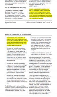

When the U.S. gummint adopted the 2010 ADA standards, they published a companion Guidelines document that may shed some light on this question:
IMHO, an existing small, single-occupant office doesn't have to do anything more than provide the required maneuvering clearances at the door when there is no furniture, and if the office is under 300 square feet it may not even have to do that (but it should). The furniture layout is a matter of individual employment accommodation, not the technical construction standards.
