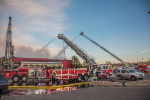

    It is not just access for personnel but for Spray deluge operations

    That Trex picture is interesting. Tight space. Looks like the truck is leaning a little due to the arm beinng extended.
