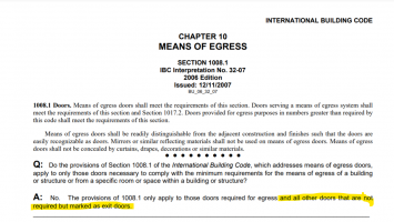

Not unless it is signed as an exit door
Isn't a path out of every room required for egress? Doesn't a door from every storage room and every kitchen have to comply with code for egress, even if an exit access door? Maybe no sign, no rating, inswing, and perhaps it doesn't have to be accessible, but there are code requirements at least for size, force to open, landings, and maybe more. I believe the code requires a m.o.e. for all occupants.
Rick18071
Sawhorse
Nov 28, 2009
3,102
Poconos/eastern PA
Thanks mtlogcabin for this. This doesn't mention doors that are not marked as exit doors so if unmarked they do not need to comply with this section.
in a building with an occupancy is less then 50 you don't need exit signs. So if only 1 exit is required in this building and there is 2 exterior doors and no exit signs and one door does not meet code as an exit because it is locked from the outside how does a person know which door to exit the building?
