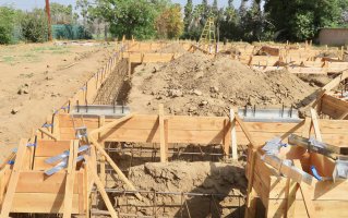

The plan calls for a two pour system with #4 dowels. The dotted line is the cold joint between the footing and the slab. We refer to it as a "shovel off". Dowels are usually bent 90°. Dowels must be tied in place.
Ok so there's no dowels. The first question is how would the concrete be piled 22" above the grade beam not to mention the lack of rebar at the top of the footing.
The form board sits on the #3 ties. The Strong Wall may not be all that strong.

That drawing is very confusing. To me it looks like what they are calling #4 Dwls @ 16" look like rebar in the slab. The bar at an angle that I call out to be 12" minimum looks very strange and as you said it doesn't look like there's any way to tie it in.
Around here I've never seen a cold joint place like that either, they are normally flat across at the top of the grade beam. Were you seeing a need to have concrete 22" above the grade beam? It looks like it's just 8" to the sill plates.
The way it is set up there would be a 22” space between the grade beam and the top of the slab.

Odd design...So is there rebar exiting the first pour through the "cold joint" into the second pour-slab? Looks like there's a horizontal bar, would that be tie to the slab mat before the slab pouring?

I see what they are trying to do, they are trying to build a standard foundation like a monolithic pour without pouring the slab at the same time, I've thought about it and don't see anything wrong with it, the 22" gap between the top of the cage and the top of the pour is highly unusual, but again I don't see anything wrong with it, I guess Tiger can request a structural observation from the DPoR since it's at variance with the plans, maybe he would request vertical dowels, or maybe he would sign it off.
