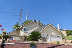

Somebody thought that I would scurry up that ladder. And that's asphalt shingles with air temp. of 116°. The ladder is probably too hot to touch. The bed cover on my truck could fry pork chops and eggs.
On a calm, soothing, winter day you're gonna need a crane to show me the top roof of that house.
You see why none of our inspectors are allowed to climb, were I your CBO I'd fire you and send yout to work for MH, you'd spend the rest of your working life measuring the heights of handicap signs.
