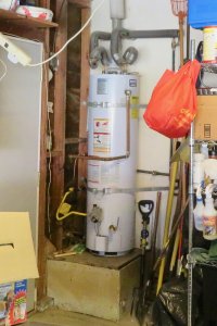

The job is an electrical service upgrade. We ask for a jumper at the water heater from the cold to hot to gas pipes. This is done to ensure that the hot water pipe and the gas pipe are bonded. Yes I know that the gas pipe can be legitimately bonded by virtue of an electrified gas appliance such as a furnace. As Tommy, the oldest Henderson boy says, "Here's the thing about that". We don't have the time nor inclination to determine what the source of heat may be. It is so much easier to get another three feet of wire and a clamp because they will be placing a jumper from the cold pipe to the hot pipe no matter what.
This is one of two water heaters at this residence. The other water heater has the correct configuration of jumper.
I wrote a correction to place the jumper on this water heater. I suspect that the workmen that installed the service panel may not have known about the existence of the second water heater. If they were aware of the second water heater they must have thought that I would not find it. In any event, the jumper was installed.
There is two clamps on the gas pipe and one clamp on the T&P drain pipe.
