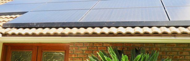

There is no tile roof under the array. The tile roofing was removed and replaced with asphalt shingles. Then the tiles are placed around the perimeter so that you can't see the asphalt shingles.
How do they deal with the seams, grout, silicone? Looks nice. Notching around partitions could be a PITA...
I didn't ask about the grout. The gaps are narrow, uniform and straight. The guy that did this had not done a tile floor before now. He is from England and came to the USA to build a huge home for his sister. He is Chinese with a thick English accent. His wife is also Chinese with a French accent.

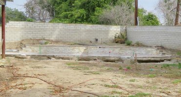

Is a guard / fall protection required due to the height of the wall and the proximity of the HVAC & electrical equipment to the wall?
The inspection was for conduit. There will be a fence with a bunch of lights.
At each location there are four upright rebar....next to the sidewalk.
