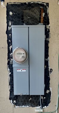

This guy caulked a bunch of holes in the lath paper but apparently he ran out of both.
I'm guessing that I asked this guy to strap a top plate at some previous job.
Ya it had to be me.
