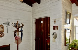

I'm sure that I posted this previously. I was looking at a picture folder and this popped up.
It's a solar company. I wish I knew what it was that I said that caused them to do this. The housewife was so wound up I bet they had to tie her up while they were installing it. I waited until I was in my truck and then called her on the phone. When she heard that a smoke detector isn't required on the front door I could see the windows bulging out.
This was failure to communicate. The company is run by a pair of Ukrainian immigrants. All of the workers are Hispanic. They have a crazy guy installing the detectors. And then they ran into me and somehow there is a smoke detector on the front door. Oh was that lady angry. I don't care who you are, I wouldn't eat anything in that house for a month....dogs included.
