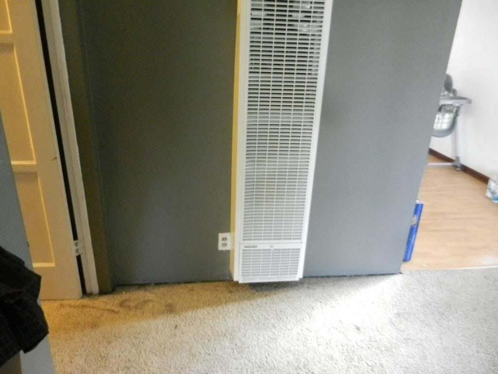

I wrote a correction that there can't be exposed carpet below the furnace. So there it is....sheet steel laying on the carpet. My guess is that the contractor has never gotten that correction before now. Well I said no and he will most likely screw the steel to the floor and request another inspection. I'll say no again and the stumblebum will try something else.

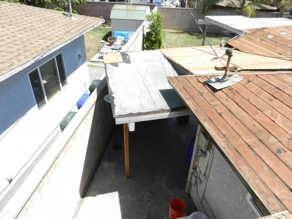

How many times have you heard a contractor say, "We're not roofing that area"? Then if I didn't make an issue about the illegal construction, they replace the roof.
How often does a contractor wait for you to tell him that a cricket is needed?

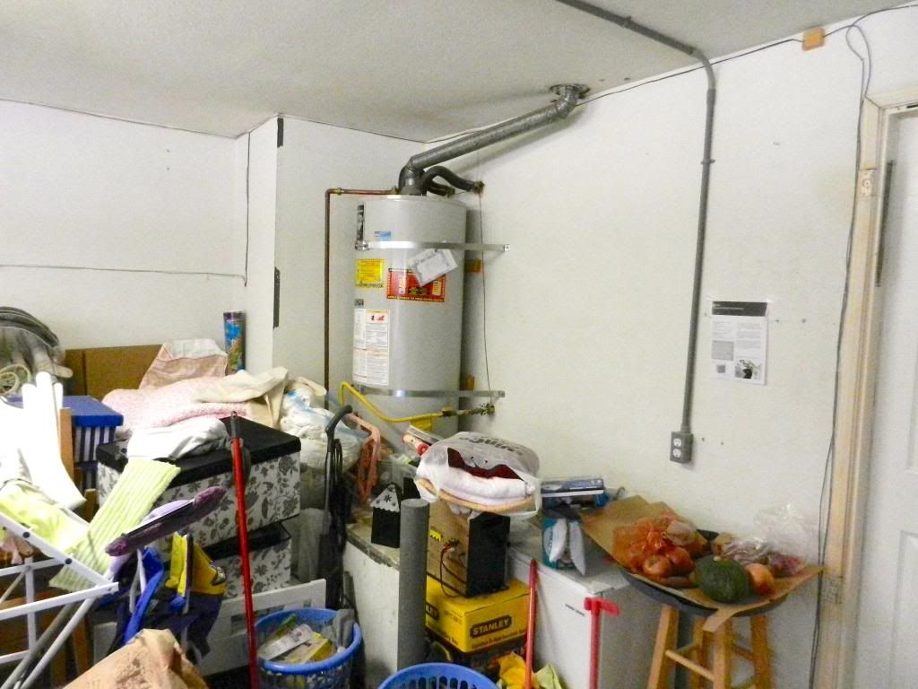

Considering the vent length, I question the consequence of adding 4' of vent connector. The gasses must now heat that pipe which robs heat that's needed to heat the vent through the roof. The tight bends of the connector, although legal, aren't helping.
Ya the bollard is a dead giveaway. Well I wasn't there to inspect the water heater as the AHJ.

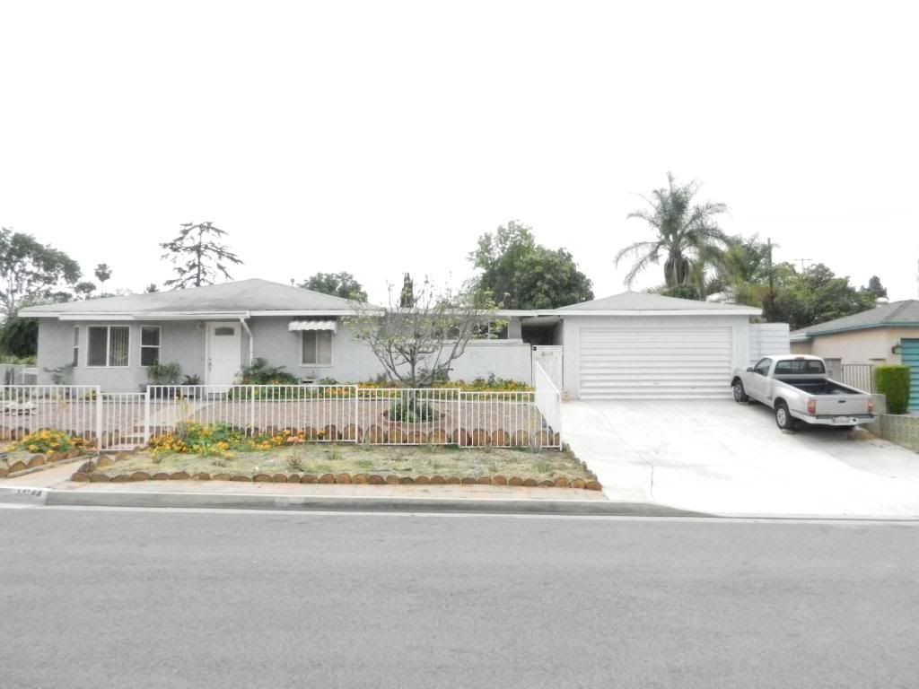

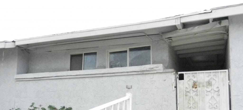

There is a complaint that the garage has been converted to a dwelling with a kitchen and bathroom. It looks like the garage and dwelling were two buildings at one time.

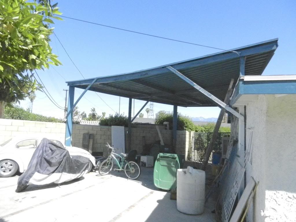

I think that there is a metal patio cover that is buried in stucco.

I like the combustible storage in front of the WH

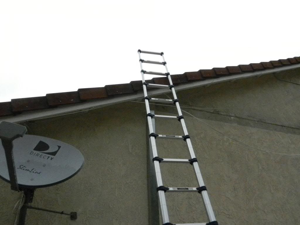

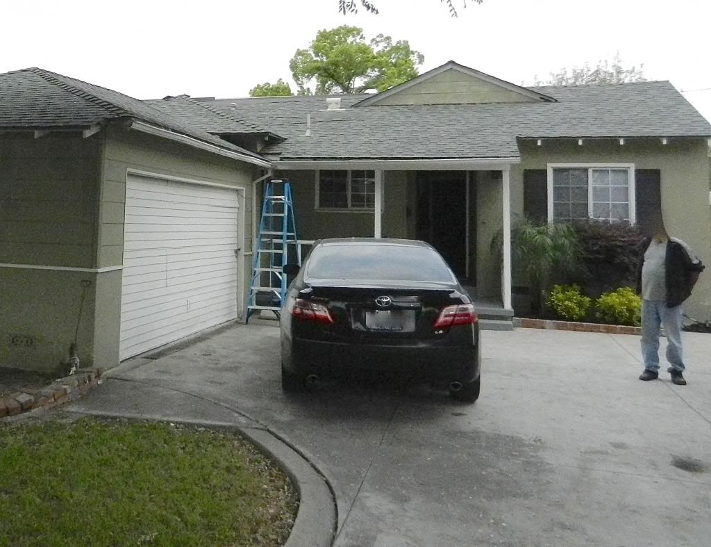

The job involves straps across the ridge from rater to rafter. The shingles were removed but I can't see the straps from the ground. I was expected to climb the step ladder. I said no. The man in the picture is the owners father and he volunteered to go on the roof and tell me the spacing and take pictures of the straps. I held the ladder for him.
Afterwards, I thought that perhaps I screwed up. Had the old fart fallen, it would somehow be my fault and Shirley, I don't need that.

They never remove the carpet before I write the correction.

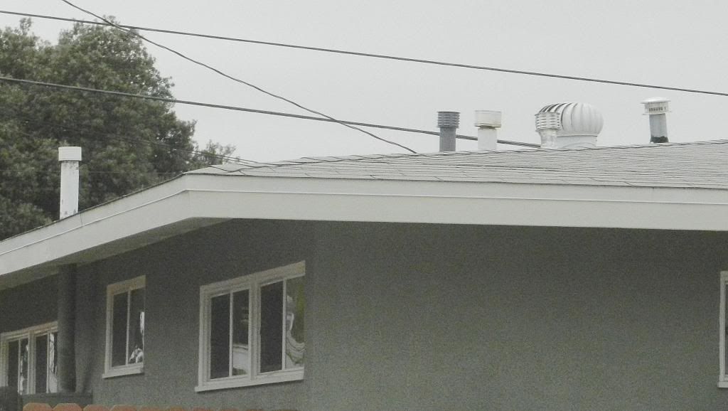

The inspection was for a furnace and A/C. I was stood up. The appliance vent on the right is for the water heater. .......... Your other right. The four through the roof...I don't know yet.
