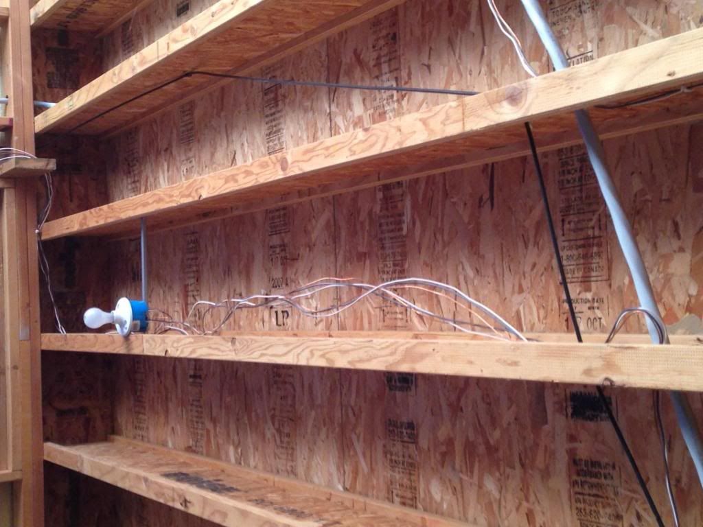

An attic storage/playroom space has been created in garage. The floor joists are 2x6. The span is 29'5". I could not find a splice in the floor joists. It would take a 30' 2x6 to pull that off. I wouldn't believe it if I hadn't seen it myself.
I've never seen a 2x6 even close to that long! You should have asked him where in the world, he found such an animal. Not that it really matters, considering there so many other problems, but...
There needs to be a "Warning! Floor may collapse at any time!" sign in that mess of signs....
ICE said:
An attic storage/playroom space has been created in garage. The floor joists are 2x6. The span is 29'5". I could not find a splice in the floor joists. It would take a 30' 2x6 to pull that off. I wouldn't believe it if I hadn't seen it myself. View attachment 2017
In the attic space there is a 2x hung from the ridge. The 2x is then nailed to the vertical 2x. The vertical 2x is toe nailed to a flat 2x that rests on the top of the 2x6 floor joists. The flat 2x is face nailed to the top of the floor joists. This took place at the mid-span of the floor joists.
The attic is accessed by a drop down stairs. I was told that the kids use it during the winter when it cools down. The owner is a fireman.
ICE said:
This was a first for me. Everything is painted black so it was difficult to see but I looked closely and didn't see any splice. A splice wouldn't hold up anyway.The lumber had to be special order and expensive. The flat black paint is odd as well. The weight of the new carpet is nearly enough to undo the entire construction.
I didn't want to go up the stairs to get the pictures but I just had to know what was holding it up. The realtor (it was an open house) must have thought that I'm strange.
