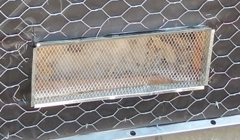

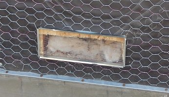

What do you say to crap work like this? They must have used a Swingline 747.
I wasn't the inspector for the raised floor framing. When I inspected the roughs, I told them to cut out underfloor vent holes. Sometime after that I told them to clear the insulation from the vent holes. The piece worker said "I know that and you aren't here for that". At the final inspection, I will tell him again because, well then of course, I will be there for that.
They left a broken screen because they just don't care.
Going back a couple pages: "How can you blame the grunts in the field? The plan view shows an 18x18x 12" thk footing, but the detail shows the footing min 26" thick. Archy screwed up."
IRC requires foundations to be at least 12" below undisturbed ground, and untreated wood posts to be at least 8" above grade.
Most sets of drawings and/or specs. have notes saying that larger scale details take precedence over smaller scale plans or details, and to contact the architect if a conflict is discovered. When I was in private practice I always asked contractors to let me know when they found a conflict or mistake on drawings I had done, so I would know better in the future, and not make the same mistake again. Unfortunately, I went on to make new mistakes more often than not.
conarb said:
Tiger:The biggest problem is that that vent isn't flashed at all, those cuts in the corner of the lath paper are going to leak and rot out the joists.
It will look better when they get done caulking the the paper to the penetrations. That's what the correction always says, "Caulk the paper to the penetrations". The result can be a whole nother problem.
