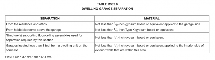

OK so the new 'spin' that I hear on this is that an attached garage, although required to be separated from the attic with 1/2" gypsum or equivalent (with no habitable rooms above) is meaningless because 1/2" gypsum has no official fire rating, therefore a wooden pull down ladder installed in a garage does not have to be the equivalent protection of the 1/2" gypsum because the gypsum has no official rating.
I really don't agree with this. What say thee?

You might want to start reading this section then:
Nothing in the IRC requires any fire rating for the walls or ceiling between the garage and the dwelling unit.
The IRC does have minimum prescriptive requirements of which the 1/2 gypsum board is one of them. Install the 1/2" gypsum board on the face of the drop down ladder and you are done IMHO.

19/32-inch wood structural panel bonded with exterior glue will give you the same 15 minutes 1/2" gypsum board will.
2012 IBC TABLE 722.6.2(1)
Remember the IRC is a prescriptive code not a design or performance code. It is all about increasing the time for the occupants to get out of the building in a fire event. Even NFPA 13D only requires a 15 minute water supply in a sprinkled residence.
Just went from the 2009 IRC to the 2015 IRC and did not know about that table. Did not do any 2015 plan reviews yet. So now they only need 1/2 on this ceiling while before we required 5/8 for this situation. I always considered an attic above the garage as part of the garage if 5/8 was not on the garage ceiling.
So why wouldn't you need to go by this section for the opening to the attic? Would you be ok if drywall was glued to a swinging door too?

Just an idea, but who thinks that Table 722.6.2(1) would prove a worthwhile argument.
Per IBC Table 722.6.2(1), 1/2" GWB provides 15-min resistance. To achieve an equivalent resistance, 19/32" WSP is required.

This is exactly how we handle it.
Our state amendments require 5/8" on ceiling & walls if no attic separation. If separated 1/2 on ceiling but still 5/8" on walls.
We allow the drywall or 26 gauge sheet metal attached to door, or a rated door.
Drywall attached to the door will likely overload the springs and keep it from closing tightly. Fire-rated attic stairs are available, of course they cost more.
Fire-Rated pull down attic ladder is the way to go. Costs are not our problem. If you want a pull down ladder to your garage attic, it is on your dime. There are other ways to access it or design it.
We amended the table to 5/8" Fire-X type rock from residence to attic separation.

A ranch home with a built in garage would have a common attic between the living space and garage which is often the issue.
Around here, garages are not heated or cooled. Therefore they're not conditioned space, and fall outside of the building thermal envelope. To accomplish this, drywall is hung all the way to the roof deck on the wall(s) separating the house and the garage. If that drywall is there, then whatever finishes and pull-down stairs you want in the garage are fine with me.
