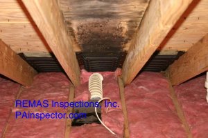

Perhaps Jar can shed some light on this one since he took the picture (when he worked on the dark side) if it vented to the exterior or just to the soffit. Either way it is easy to see that the moist air came right up the insulation baffle and that is why there should be no soffit vent openings within 3 ft either side of the exhaust opening.
That looks like it was exhausted to the exterior but right above the outlet was a soffit vent. That is obviously non-compliant and one should cite R303.5.2 or M1504.3 because there is a soffit vent opening within 3-ft of the exhaust termination.
