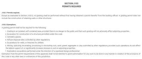

If a state agency grants a permit for the installation of fill on a property(empty lot), what, if any part of the IBC/IRC would require a building permit?
I say there is not building permit in this case until they decide to build on it.
Depends on if the local AHJ has adopted Appendix J through their municipal codes.
Locally, even though the State (WA) does not adopt Appendix J, we do through our municipal code. This is done in partnership with our cohorts in planning, as it ties into their world (flood plains, protected environments/species, etc.).

In our case, I am on a barrier island and everything is built on pilings that go down 40-60 feet or more. When they decide to pull a permit for construction, then we can plan check the soils. Until then, the only permit needed would be if they municipality had an ordinance which should be under planning or zoning. Not building.
Sounds like all parties here do not adopt Appendix J? Can anyone shed some light as to why you do not adopt it within your jurisdiction.
