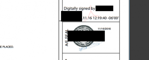

This is what Bluebeam sees when a signature is valid. There is a ton of more information you can drill down to if necessary when there is a problem.
When the PDF is not digitally signed and sealed, the signature tool is empty. They may have a stamp shown on the plans but it is not valid without a digital signature. See below.

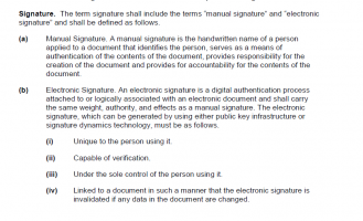

Following are two excerpts from the state board. I have a plan in front of me, a pdf reviewed with BB. It has a seal, with a date and signature across the seal. So I wonder how it has come to be. Was it a paper plan, which has been scanned? (That seems unlikely) If the plan is "computer generated" (likely), was the stamp also computer generated? Is a pasted image considered "computer generated? What does "computer generated" mean? (the same rules apply to architects)
This is good example and the norm, but I do see lots that are barely legible, obviously scanned. I often get letters and emails directly from DP's with a seal and signature in the same manner. If these methods are not acceptable, should they not be on top of this? Occasionally I do get "electronic" signatures, and sometimes the actual seal disappears. Is that what is supposed to happen? This seems like a mess. If there are definite protocols then they should be policing themselves, and informing us how we can determine the validity of their documents....if they want us to. I recently had two occurrences of a contractor taking a page, adding designs they created, and submitting it as a revised page. In these cases, the revisions were suspect for various reasons, I called the DP, and he knew nothing of them. In both cases, there were no consequences! My guess is that this happens far more than we realize, but based on my experiences, the DP's don't seem to care.
Why didn’t the DP report the situation to the state licensing board?
No idea for sure. Likely to promote and/or maintain a relationship....$$$$. Could be the hassle wasn't worth the cost. Either way, it sent a pretty strong signal to me that they didn't really care.

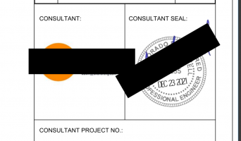

Here is another example. The seal and signature are barely legible, but it is "digitally signed"...but the whole thing is a copy, of a copy, of a copy(?). I see many different iterations of seals and signatures, just don't know if they are valid, and unless something throws up a red flag AND I am taught how to make the proper determinations I move on to the review, which is done the same whether sealed or not, valid or not.
What is visible on the PDF as you see above is not relevant. What is inside the PDF as shown a few posts above by me is what's relevant. I can do just about anything to a PDF document between BB, AA or even Photoshop. This is why the digitally signed and sealed drawing verification is so important. It is actually better than a wet stamp and paper.
View attachment 8452View attachment 8453
(b)
(II) Capable of verification.
That says it all. Only capable with a 3rd party verification service used by the RDP
Unless it is a copy. State rules say "digital authentication process attached to or logically associated with"...Huh?
So there is a method where the RDP digitally imbeds a long, alpha-numeric code and then you have to contact the RDP to verify the code. The problem is that the law also requires that if the documents are altered, it is required to invalidate the signature. So no, no scanned copies.
