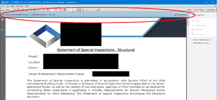

We are fighting this battle now. The state laws governing architecture and engineering have included specific requirements for digital seals and signatures for many years, but what we usually see is just PDFs with what is obviously just a JPEG scanned image of a seal and signature. That doesn't cut it. The law requires third-part authentication. Our state building inspector recently sent a notice to all building officials that we have to start checking this.
The major PDF readers have long had provision to do this. If I open a document with a proper digital seal in Adobe Reader, Adobe Acrobat, Bluebeam Vu or Bluebeam Revu, the software pops up a notice that tells me the document was digitally signed -- and whether or not the digital signature is valid. If Adobe doesn't pop up this colored band across the top -- any seal and sinature are nothing but a scanned image of a seal and signature, which is NOT a proper digital seal.
Here's a sample in Adobe Reader: (note that this was submitted several years ago. The digital signature was valid when it was submitted, but the engineer's authentication key has changed since then):
I should add that we don't have to understand what "flattening" is or how it works. The laws (at least in my state) require digital seals and signatures on electronic submittals, and the laws spell out that this means third-party authentication. How the design professional accomplishes this isn't my problem. The laws have been on the books literally for decades. The larger A/E firms seems to have figured out how to do it. If the smaller guys want to stay in business in the digital era, they're going to have to learn how to do it, too.
We recently rejected a set of drawings from our arch-nemesis, a PE civil engineer in town who likes to play architect. His digital drawings have seals that don't pop up the recognition of a digital seal, so it's obvious that he just scanned a seal and signature and pastes it into each sheet. When we flagged it, his excuse was that he is aware of the law but that he doesn't do it "out of concern for security." Which is a crock, because anyone can copy his JPEG seal and signature image and reproduce it, but nobody can copy a proper digital seal and signature. So what he really means is that either he doesn't have a clue how to do it, or he's too cheap to pay a third-part authentication service.
Bottom line (for us) is that if we open the PDF and we don't see the notice that it's a valid digital signature -- the documents aren't acceptable.
A proper digital signature will either change or disappear if the document is changed after it has been signed.
