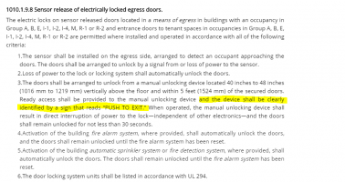

A Milwaukee client currently has these buttons on their elevator lobby going into their suite. They are asking us if they could replace this button a blank button (not engraved) and reword the nearby signage to say 'push for emergency', instead of 'push to exit'. I can't find on the requirements online if the button itself needs to be labeled or engraved or if it can be blank with adjacent signage. Has anyone come across this before? Thank you.
