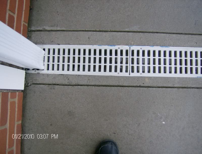

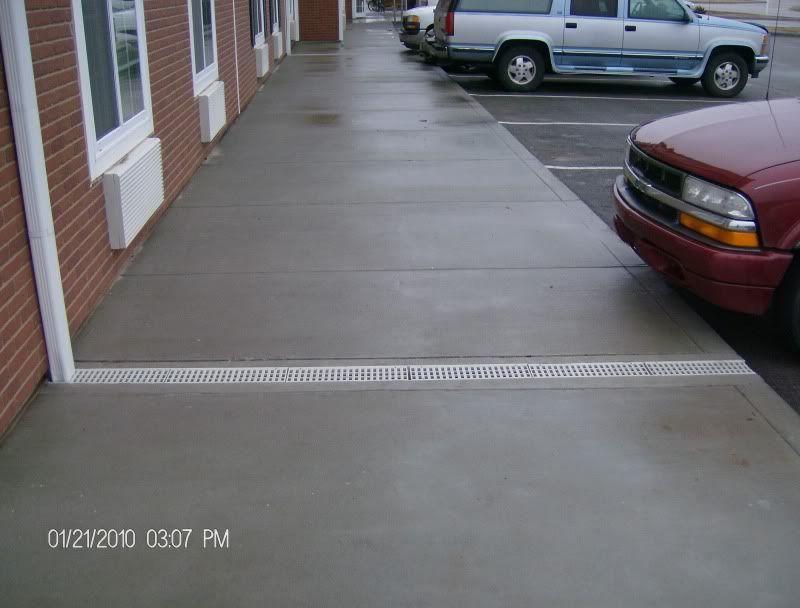

This is one way it should look;
(click on picture to enlarge; downspout from roof)
(grate and drain to pavement)
(the drain cut into the sidewalk & downspout to drain)
Some use a solid cover on the sidewalk drain.
Uncle Bob

Re: down spouts and walkways
Uncle Bob said:
This is one way it should look;(click on picture to enlarge; downspout from roof)
Uncle Bob
I love it.
Now the ice forms in the parking lot where a person:
1. cannot see it when getting out of their car.
2. cannot avoid it when using the parking lot.
It's epic.
But a little to subtle for there I fixed it.
