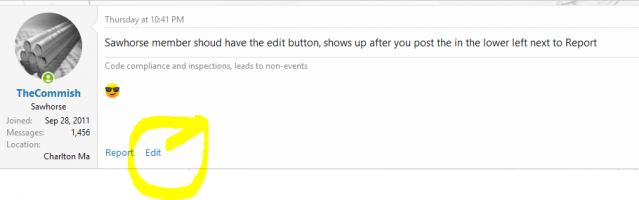

** my250r11 ** & others, ...if you are a "paid subscription member"
[ i.e. - a Sawhorse ] and you are having problems with your account,
or are not seeing various features that should be available to you,
then please send
** jar546 ** a Private Message ( a PM ) to request
assistance.......He is always willing to help !
