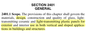

In the case of the plexiglass enclosure, the path to the yard, court or public way is blocked. A person would not be supported on the enclosure. A person would most likely fall through the plexiglass and suffer lacerations as well as blunt force injury.

In the case of the plexiglass enclosure, the path to the yard, court or public way is blocked. A person would not be supported on the enclosure. A person would most likely fall through the plexiglass and suffer lacerations as well as blunt force injury. I do not agree with the placement of an EERO over any obstruction that prevents safe access to the yard, court, or public way. The plexiglass has rendered the EERO useless. I would not be able to approve this.
