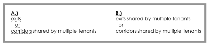

quick survey... how do you read this verbiage ?
IEBC '21
804.1
- The requirements of this section shall be limited to work areas that include exits or corridors shared by more than one tenant within the work area in which Level 2 alterations are being performed, and where specified they shall apply throughout the floor on which the work areas are located or otherwise beyond the work area.
IEBC '21
804.1
That's a tricky one. I've always read it as B, but I could see the argument for A.
