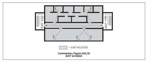

From the IBC Commentary, in Chapter 2: Definitions:

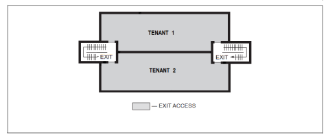

And here's the above diagram, modified to show how you can have multiple tenants with direct exits, without any corridors. It doesn't have to be a 2-story building, either. This can be any number of stories if you introduce an elevator with a shared lobby near the center of the building.
